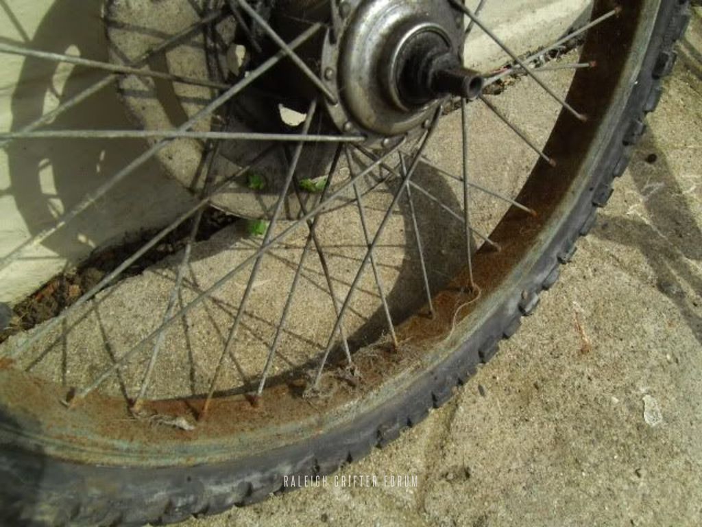

Post by retrobiker on Jul 31, 2011 17:11:15 GMT
wheels ok but really need rechromed, only going to be a cheap rider this one before  after
Post by tonyg1971 on Jul 31, 2011 17:24:06 GMT
wow mike serious top job done on those mate,,to look at them before they was a mess,,to look at them now wow.well done mate.

it was using toads method
scalpel blades to cut the top of rust of
, then these like pads, they use them in car bodyshops,
then bit of 000 wire wool and wd40 lots of elbow grease
good washdown
just to autosol them up,( will do that tomorrow ) there not mint but a lot better

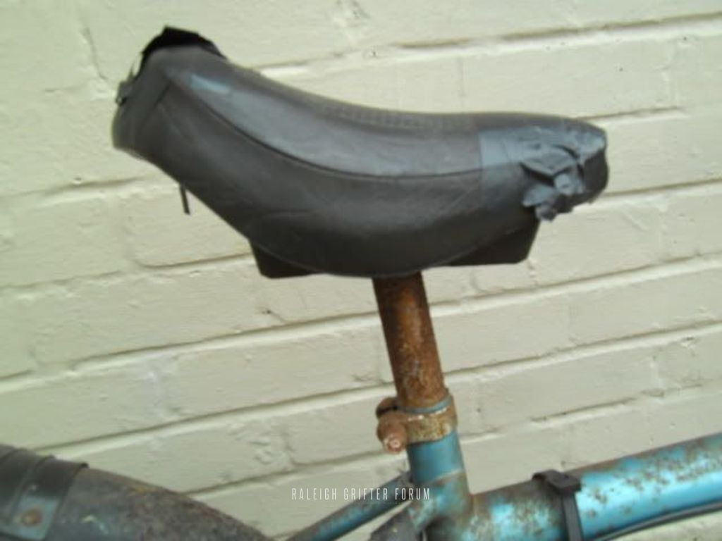

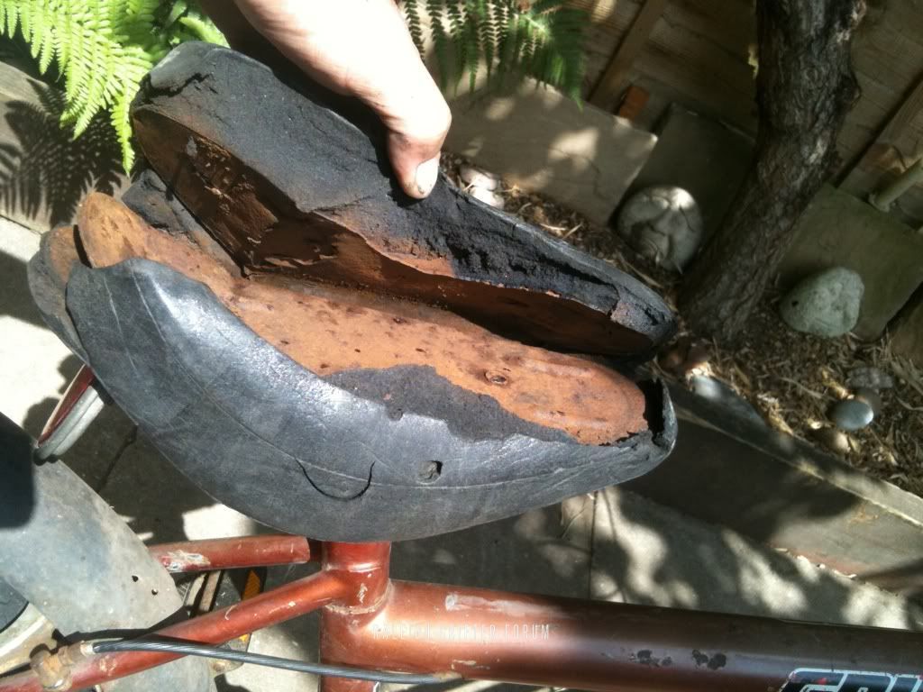

if we ask nicely he might tell us how  before  same seat

Here's some before and after picks of the rear end ;D  Looking 100% better now I think   I will do a seat thread when I stop driving up and down to devon every 2nd3 nights to see my nan long story  I offer the seat help to anyone that needs it my next project is going to be this.  It's off jaylow the only brown Mk1 on the forum
Post by hazchoppers on Aug 2, 2011 0:41:48 GMT
wow mate that is one top job... transformation is amazing! i've got one which needs a little work but dont want to put more jobs on you mate and hope everything is ok with your nan too !
Post by tonyg1971 on Aug 2, 2011 10:13:28 GMT
what did i say?i said the toad would sort that seat,,and look what he has done.amazing job done there toad,just amazing,you are the man when it comes to salvaging parts peeps would normally just chuck away,,amazing and brill how you do these repairs...top fella and a gentleman at the same time...well done toad.
