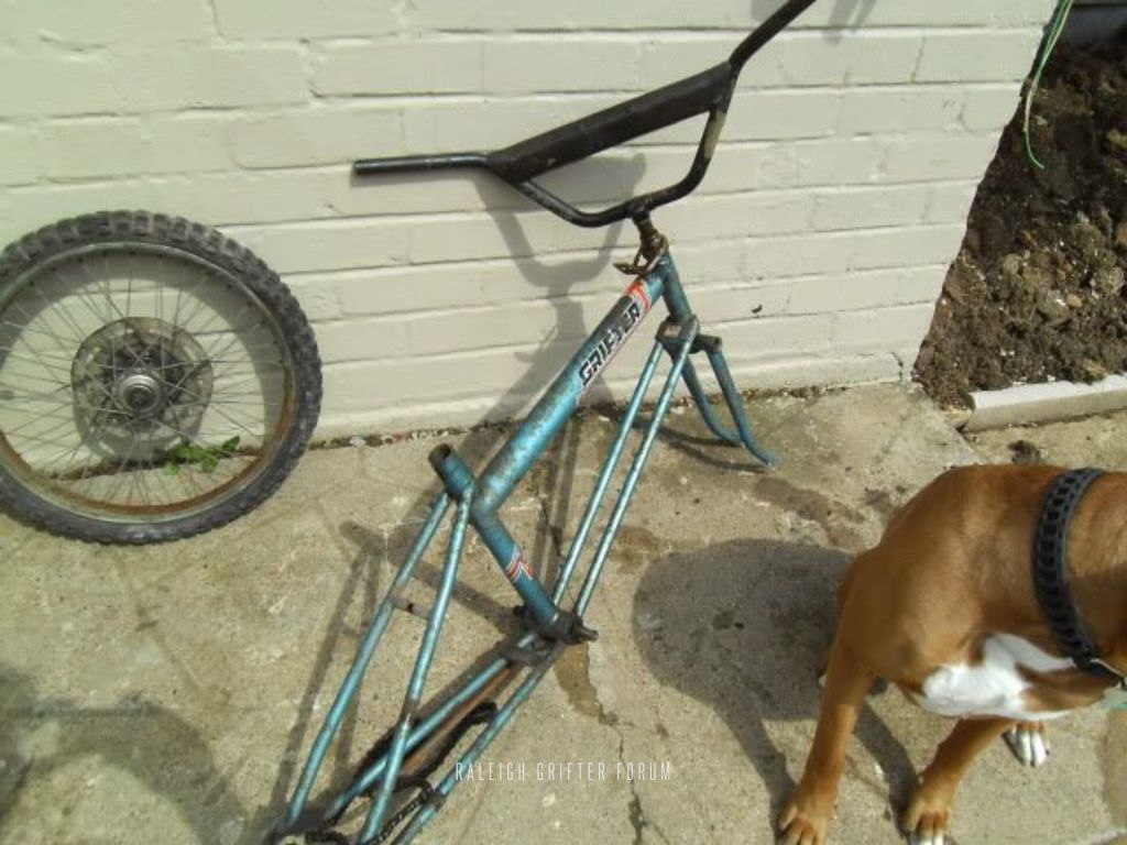

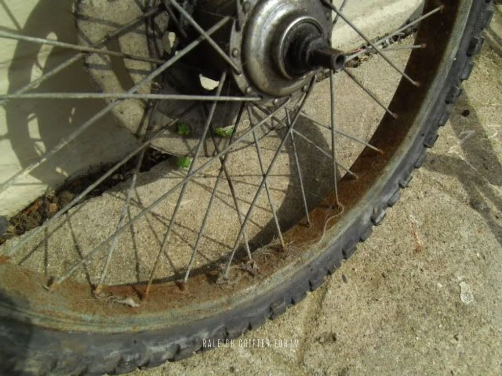

here we go, got the dreaded cotter pins out, seat was also stuck but eventually it realeased but handlebars...... had this in the past need some tips on how to release dont say cut them because Mk1 forks are pretty hard to come by  rear wheel in all its glory

well tried to heat up the stem, threaded part thinking that would expand it, but no joy
tried to twist it and break the rust but all thats happening is the forks are twisting... so i am stuck for time being
rest of bike stand , bracket etc is out
need some more ideas or different approach

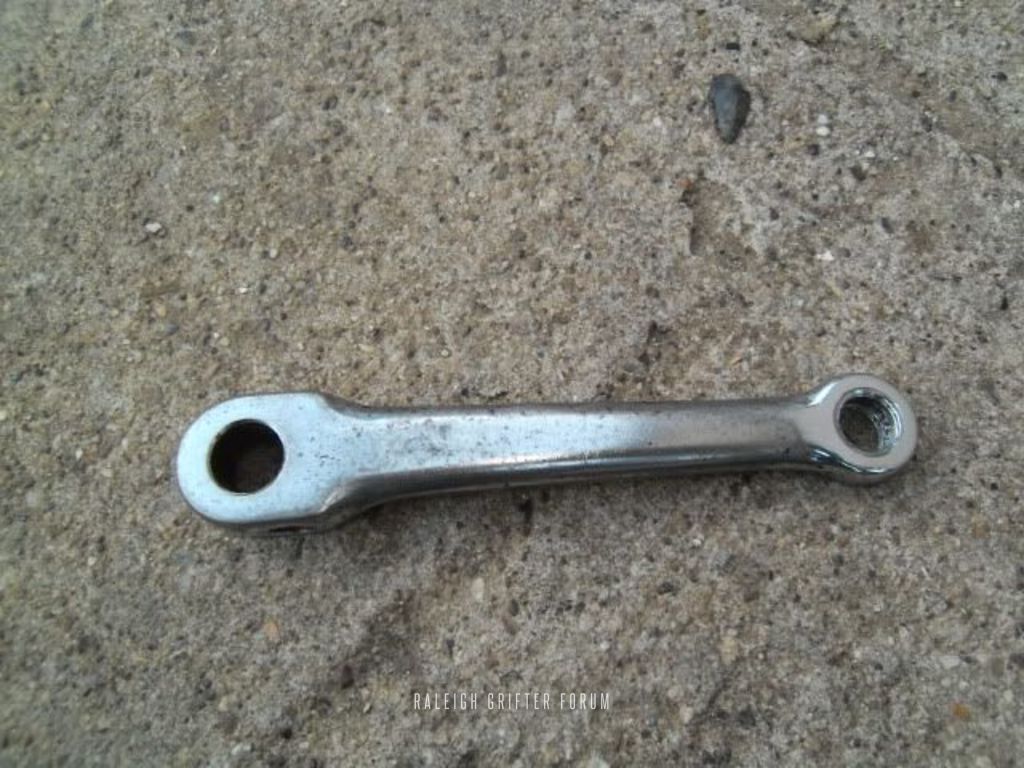

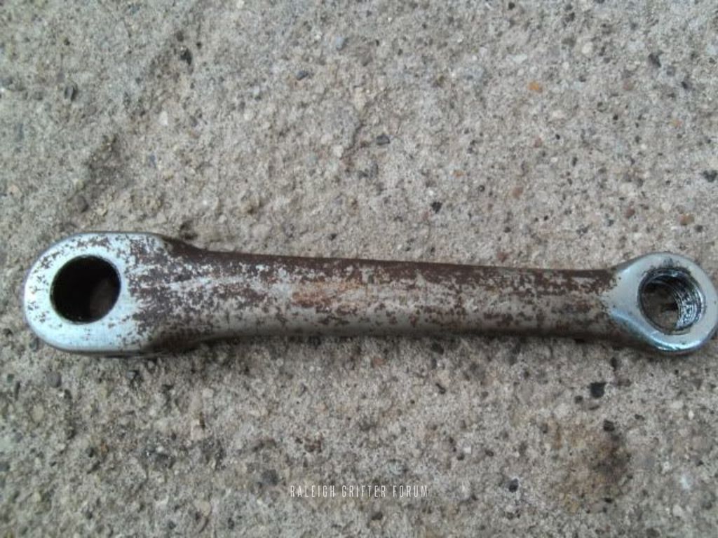

been trying some chrome bits out, some are better than others front wheel i reckon will come up pretty good, rear looks terrible but i can at least make it better some test bits , really heavy rust with a bit of work not to bad i have some spare parts so may have to use them worst side of crank  bit of clean up... still needs a bit more but better
Post by tonyg1971 on Jun 30, 2011 20:42:38 GMT
defo better,i am betting some of it has gone to far mike,and you just may have to result in using your spares.but what can clean up and be saved is a bonus mate,after looking at the bike.
Post by tonyg1971 on Jun 30, 2011 20:44:51 GMT
think i might invest in some oxalic acid,i need something real good for the parts i have,and if it works its magic,then ill be happy.
