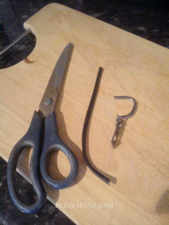

Needed to address the problem of the brake stay sheath (or lack of, as the original ones had perished). Now I know these are still available to buy for only a few pounds but I didn't want the hassle of ordering a set of tiny rubber tubes when I have a perfectly good amount of rubber electrical cable sheathing in the shed, so my improvising (and tight fistedness) skills have come into play again. Scissors, sheathing, and brake stay...

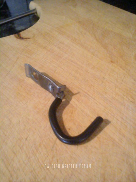

et voila.... a little fairy liquid and a tiny amount of heat and I have one sheathed stay
 Blue Peter eat your heart out!!
Post by gingerrich76 on Sept 24, 2014 11:40:04 GMT
That's the way to do it. I used a brake cable outer to do mine :-)

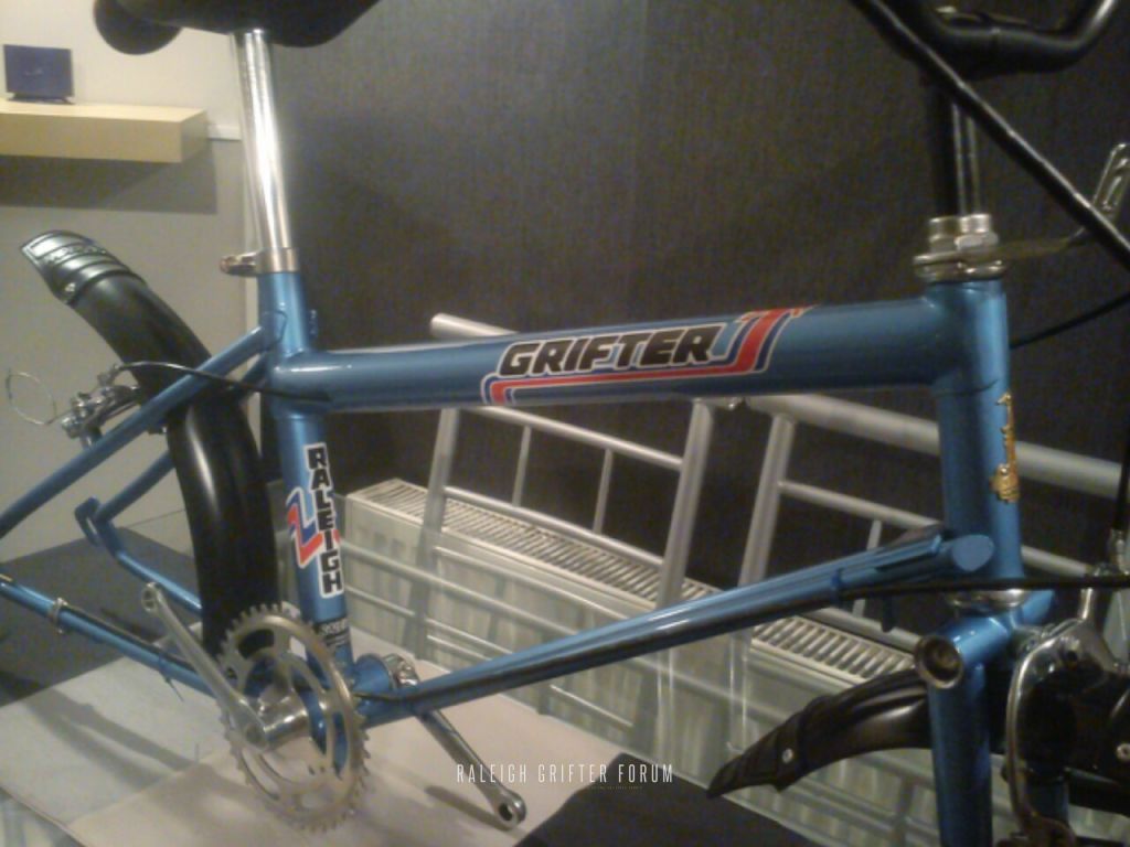

Post by markc on Oct 22, 2014 10:22:06 GMT
Decals applied last night (photo taken on phone so image not so great) The old boy now has his identity back
Post by gingerrich76 on Oct 22, 2014 11:38:21 GMT
Wow. Nice job....and your aloud it in the dining room too :-D
