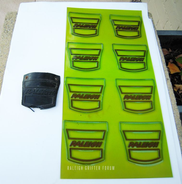

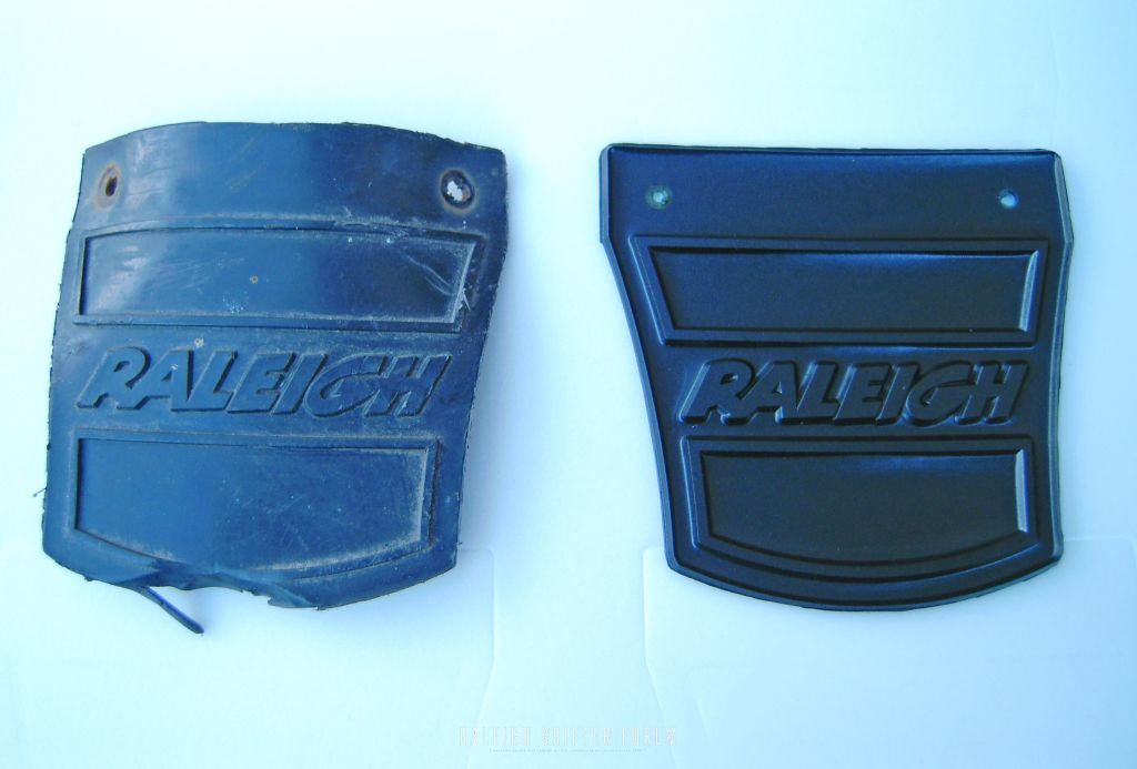

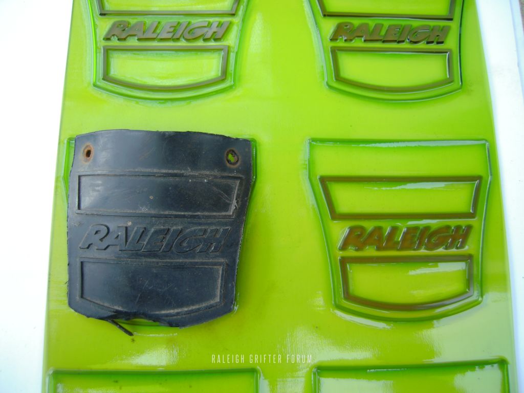

So, I came across the problem of the mudguard flaps and how they aren't in the greatest condition (in fact the two on the front are half missing) and now I've repainted the actual mudguard, the flaps look worse against them. So.....the idea: I work in the Graphic Design trade, so I thought I'd put my profession to use. Instead of spending hours (and money) looking for a set of flaps (that probably wouldn't be much better than mine....unless I found NOS) I decided to recreate a set on the computer. Step 1: I scanned in one of the flaps (the best one of the three) then redrew the shape, design, and logo in Adobe Illustrator:
Step 2:
I sent the design through our software at work to the platemaking department (we make flexographic printing plates for the label/packaging industry) who then produced me a set of plates with the embossed design:

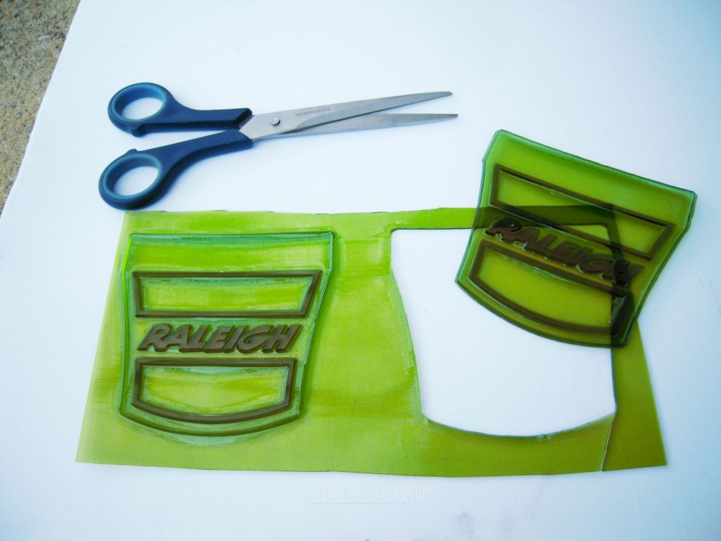

Step 3:
Use the raised outline to cut around the plate with scissors, then tidy up the edges:
Step 4:

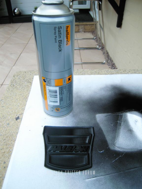

Spray paint the plate with black paint (I lightly dusted the spray so as not to build up layers of paint which may crack when the flap is bent or twisted).
Original flap vs fabricated flap:
Step 5:

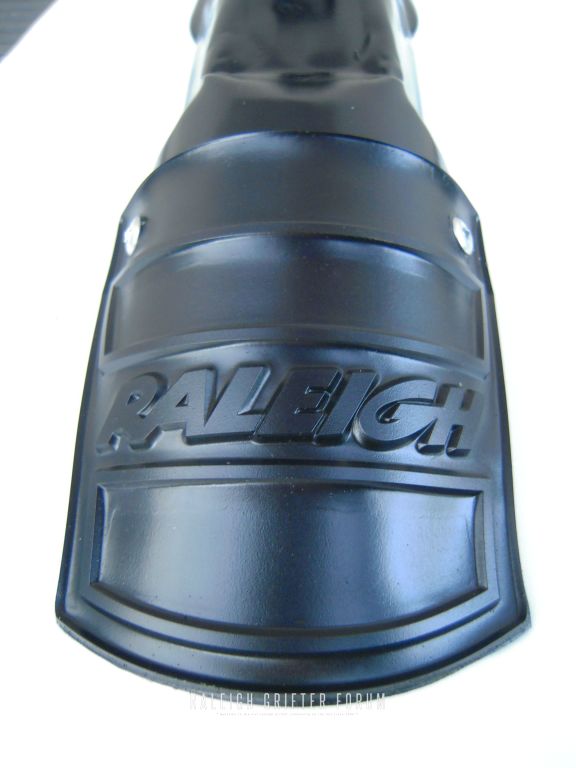

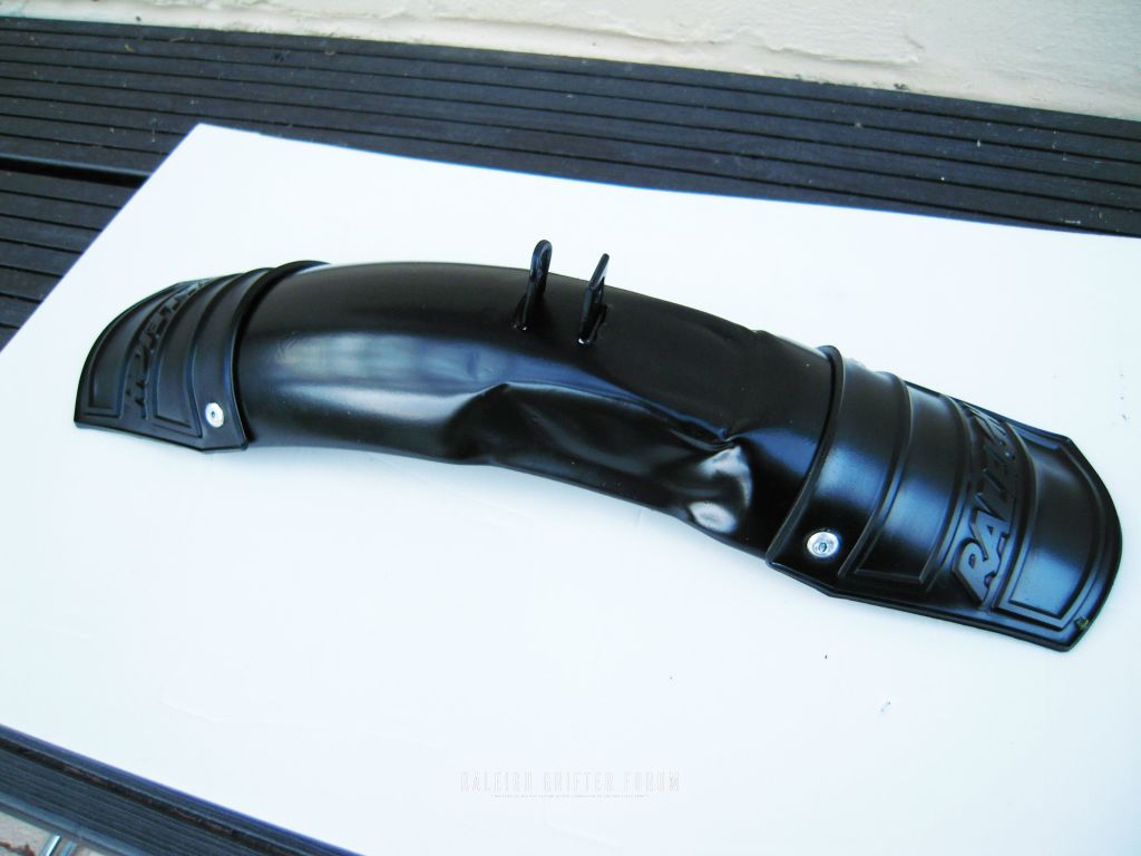

Get out the pot riveter and attach the flaps to the mudguard (the original rivets were rusted beyond repair so I used these alloy pot rivets, I thought about painting the rivets black but I actually like the 'retro riveted' look so I'll leave them unpainted).

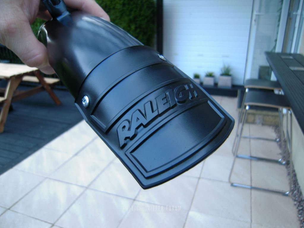

Result:
Et voila!! Not an original part but a pretty close reproduction and a lot better looking than the original scuffed flaps:
Conclusion:
I'm pleased with the result, however I think I need to invest in some Plastidip flexible paint as the flap is quite flexible and I can foresee the paint flaking off with even a small amount of agitation, I'm not planning to give this bike any considerable amount of hammer once it's done so the flaps should remain safe, though for longevity I think I need to go down this route just to make a proper job of it.
Cheers. Mark.
Post by gingerrich76 on Aug 1, 2014 11:38:55 GMT
Ooo. You could make a small fortune with them.... but would of got yourself the proper rivetts. Easy to fine and about 5 quid inc post for 7/8 rivetts. And very easy to fit too.
