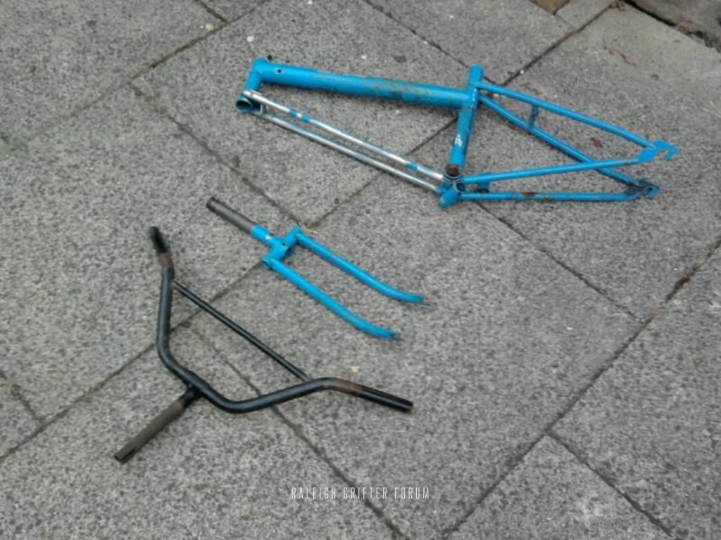

Yay, handlebars were removed complete and with little effort. Copious soaking with WD40 over the last few days worked and once in a mates vice and gentle taps with a rubber mallet it moved. We also removed the stand, a flat headed screwdriver 'bit' was used along with the usual G clamp. Now fully stripped the next stage is a visit to the blasters.

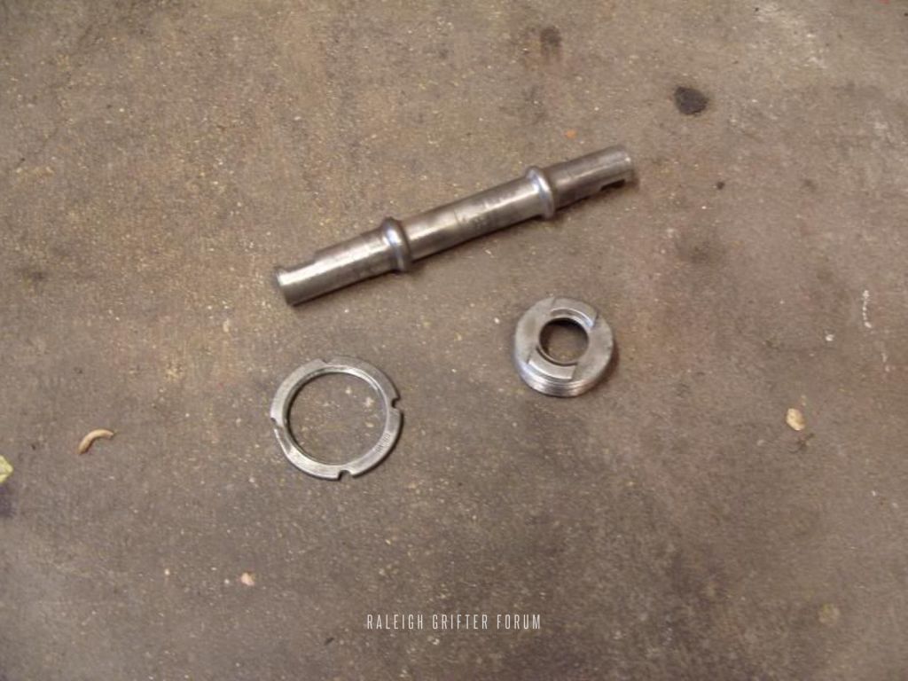

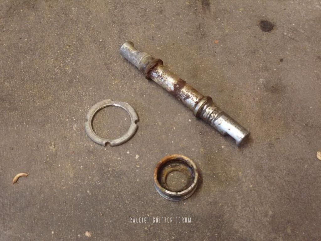

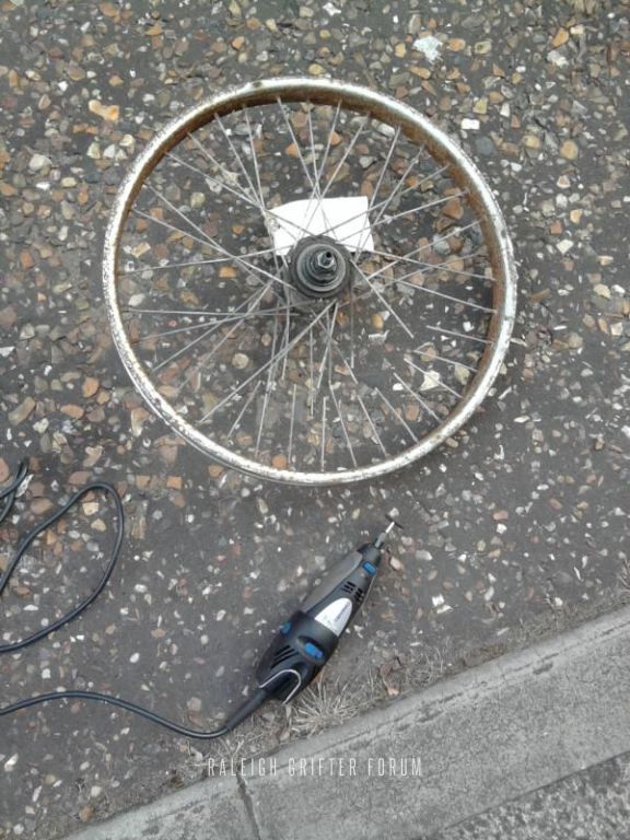

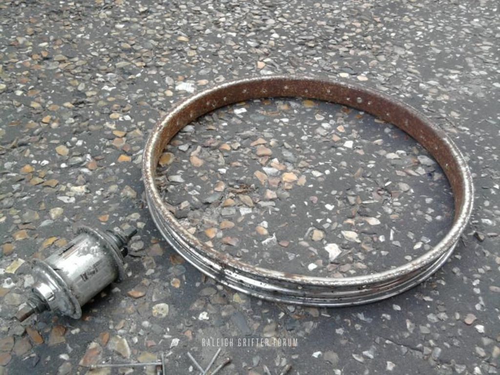

Wheels have been stripped down, a Dremil and mini cutting disc was used to remove the spokes. These have been sent off for re-chroming.  3 speed hub will be stripped out, cleaned and regreased.  Front axle stripped, this is full of solid old grease and rust  As was the bottom crank. BEFORE.  AFTER

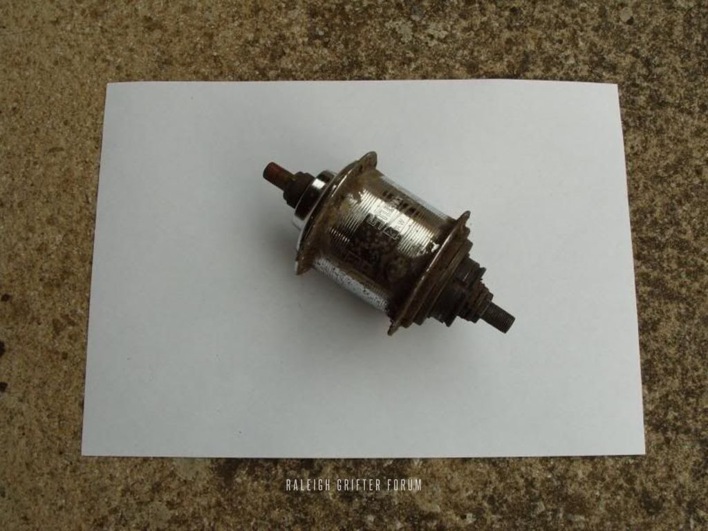

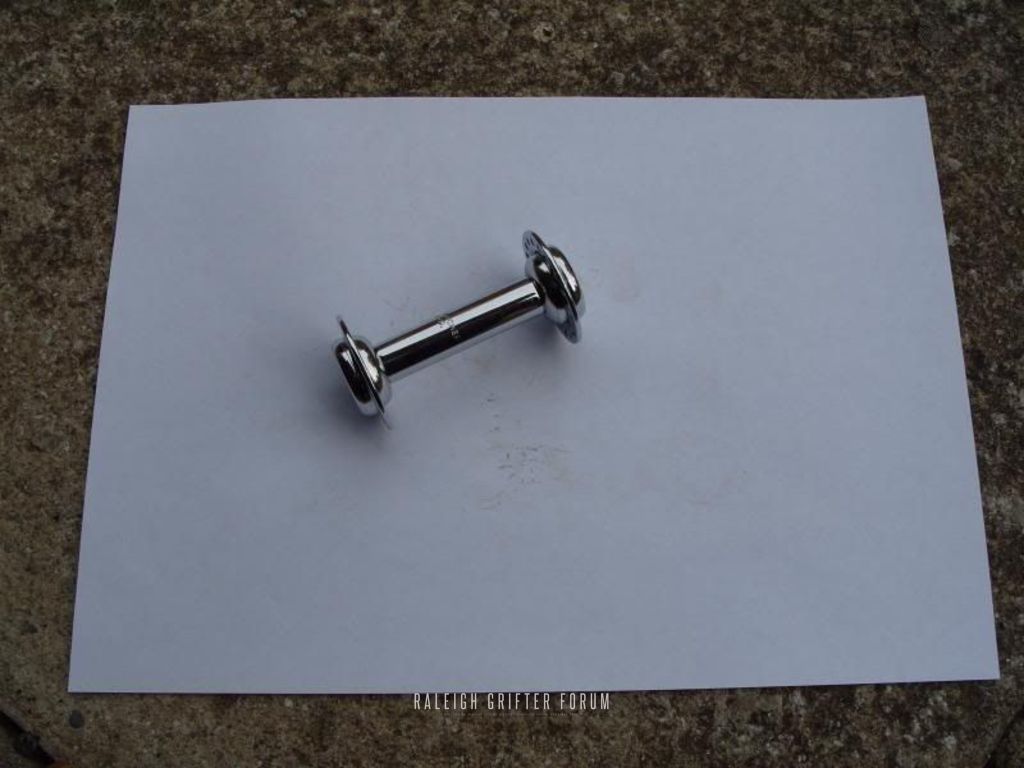

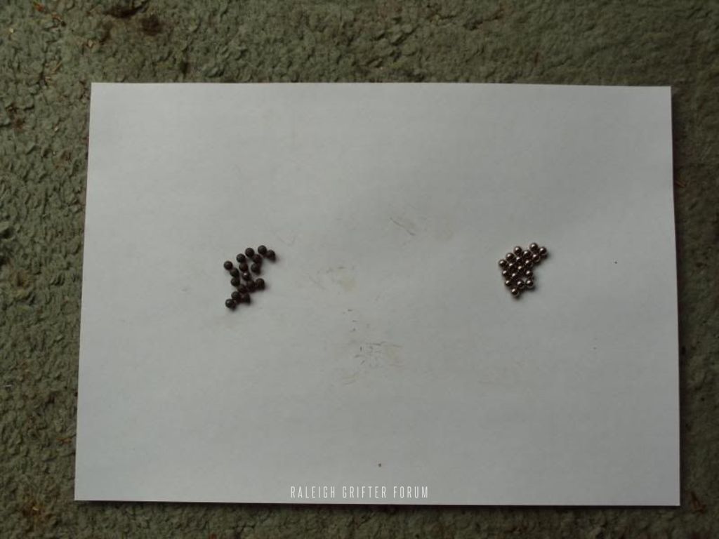

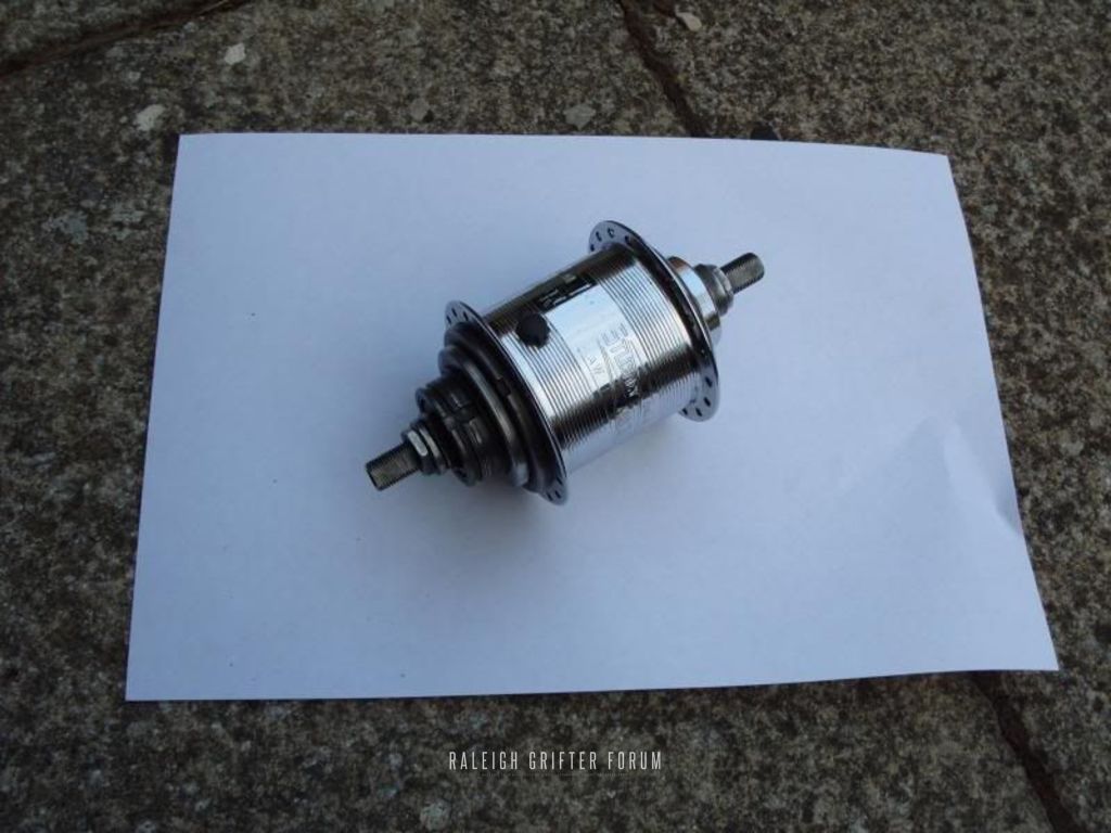

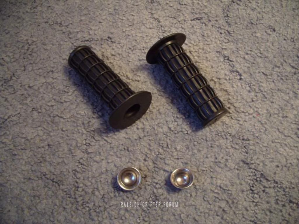

Another package arrived today, this came from Carling and contained brand new Grips and used but mint thimbles. Thanks mate  So back into the garage tonight for more work on cleaning and refurbing. Front axle was cleaned, painted black and reassembled. Before  After  New bearing were used as the originals looked some what knackered. Old on the left, new ones on the right  I then set to with the mudguards, even though they had been blasted and painted they still had slight dings on them so out with the filler to cure that.   Then the Sturmey Archer 3 speed had some much deserved cleaning Before  After

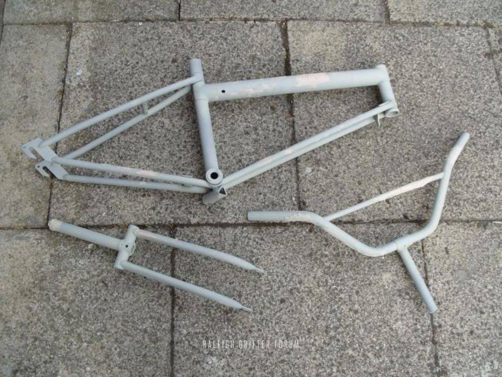

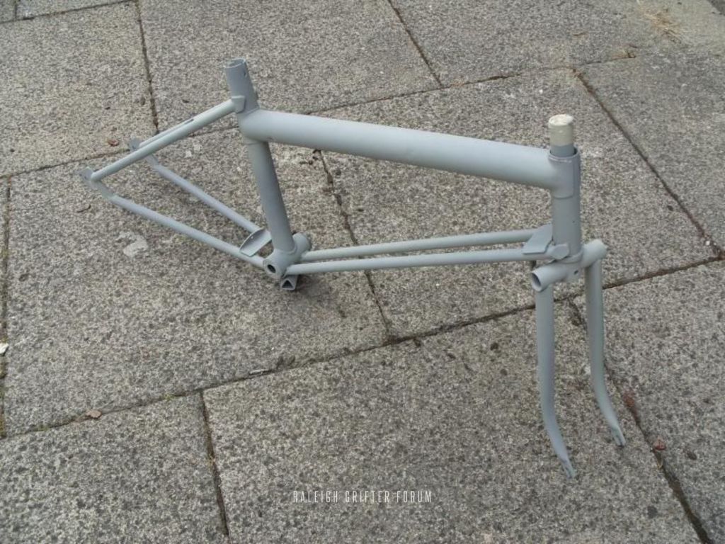

Frame was collected from the blasters today   The items are ok, but had little rust pits and marks so these were filled.  Once done the items were hanged from the garage roof and primed  Next stop is the sprayers for its blue paintwork.
Post by 4737carling on Jun 26, 2014 20:50:04 GMT
Did you etch prime the parts before the grey primer?
