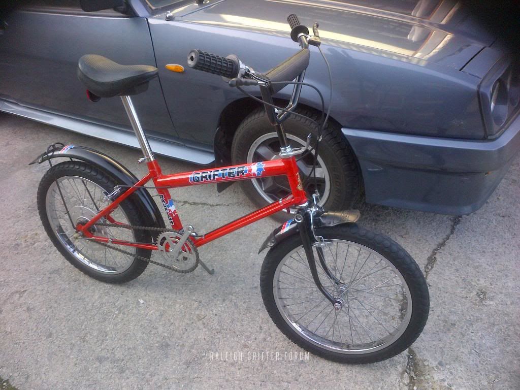

Post by U2 invisible on Oct 19, 2013 16:56:54 GMT
That's right ste, I try and leave as much of the originality as I can, I have replaced the top tube decal but the rest will get polished, as I'm using the bike as a rider I'm fitting Mk1 bars and Mk1 seat as I think the bike rides better plus I will be fitting used supergrips ;D

Post by U2 invisible on Oct 20, 2013 8:49:02 GMT
cheers mate, still needs a polish but at least i can see it now, i will just do a few brush fills on the worst chips/scratches

Post by U2 invisible on Oct 25, 2013 8:41:58 GMT
the previous owner in there wisdom had belted the chainring side cotterpin with a hammer, bending it over quite badly, i hadnt noticed because they had wound an oversize nut on to disguise there butchery, anyway it needed sorting and it was a bitch to come out, the hammer and punch werent having any effect so i ended up having to drill the cotterpin out, first with a 3.5 drill bit, working up to a 4.5 and then 5.5, then tapped the remaining cotterpin through with a punch.... all sorted now with a new cotterpin fitted ;D
